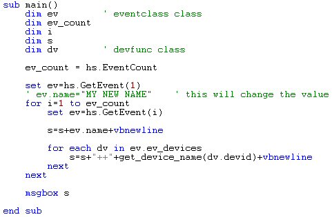

The following script shows how to reiterate though all events, get the event name, and reiterate though all the devices the event controls.
