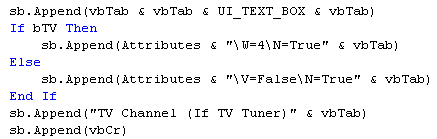

The following example shows the control only if the user has a video capture device in their system that is also a TV Tuner device:
This example sets the list index to the 2nd entry in the case where a video capture device has more than one input:
Note that in each example, these special control codes
are appended to the existing value of attributes, which is a string variable
already containing "0" or "1".
