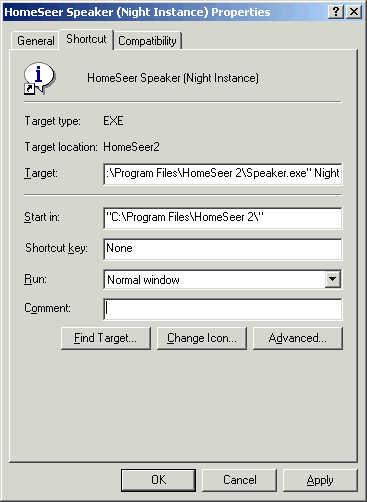

If you are starting the speaker client from a shortcut that you have added to your Startup folder in Windows, you would add the instance name to the Target field of the shortcut, which would look like this:
Use the Options screen of the speaker client to show you the name of the instance it is using and to confirm that your shortcut was created successfully.
