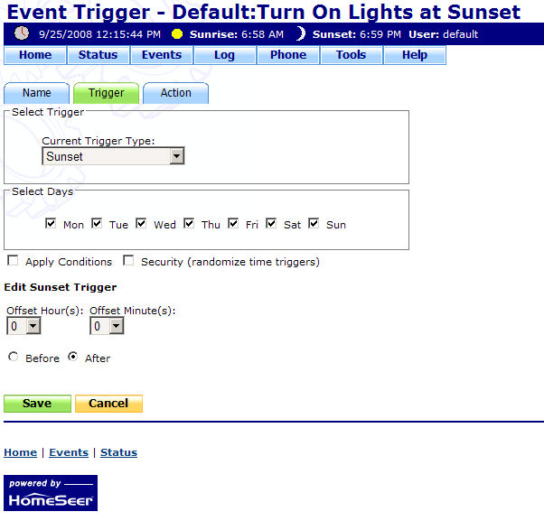

Use this trigger if you want the event to run at, or in relation to, sunrise or sunset. The time of the next sunrise and sunset is displayed in the screen for reference. HomeSeer calculates sunrise and sunset depending on the location set in the Location Configuration Settings screen.
Select whether the event will run before or after sunrise or sunset, then set how far before or after sunrise or sunset it will run. For instance, to have the event run 30 minutes before sunset, select the Sunset radio button, type 0:30 in the Offset field, and select the Before radio button.
