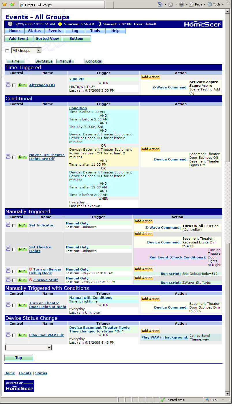

The Events screen is where events are created and modified. Go to the About Events page for more information about events, triggers, conditions, actions, and event groups.
To get to this screen, launch the web interface, then click the Events button beneath the time and date bar (if the option to display it was selected in the Web Site Setup screen). You can also get to this screen by clicking View > Events in the main HomeSeer Windows UI screen.
Note in the 2nd event that it has three condition groups. If any one of the groups is entirely True, then the event will run. The second group is needed to cover 11PM to midnight. If the condition was "After 11PM" and "Before 2AM", it would never be true.
In the "Set Theatre Lights" event, the Run Event only happens if the conditions on that event are True at the time.
