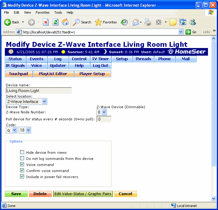

The Modify Device screen is where you modify devices that you created previously. The options and settings that are set or enabled in the screen depend on how the device was created or last modified.
To get to this screen, launch the web interface to get to the Status screen, then click the device's name to get to this screen.
The appearance of the screen may vary slightly, depending on the device type selected when the device was created.
Starting with HomeSeer 2 build 2003, additional functionality was added that allows you to change the name of the device location field, and for there to be two of these location identifier fields. (Enable option "Use additional device identifier property" on the WebSite tab of Setup.) Thus, please note that "Location" may not be the label used for this field on your system.
