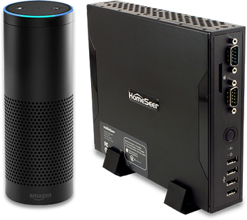

Amazon Alexa Integration
HomeSeer offers 2 powerful ways to control your home by voice!
Leverage the hidden power of your Amazon Echo with a HomeSeer home automation system! We offer two specialized skills, optimized for basic and advanced needs. These skills may be used simultaneously or you can use the guide below to choose the skill that best fits your lifestyle.
Requirements (things you’ll need to get started)
- Amazon Echo
- HomeSeer HomeTroller or HS3 software (requires version 3.0.0.293 or later)
- MyHS web service account

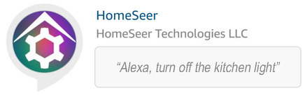

Option #1 - HomeSeer SmartHome Skill
Works with all On-Off-Dim Devices, Thermostats, Door Locks (Lock Only)
Note: This skill is available for use in the US, Canada and The UK
Sample Syntax
- “Alexa, turn off the kitchen light”
- “Alexa, set the thermostat to 65 degrees”
- “Alexa, turn on [event name]”
Setup
- Follow the Echo setup instructions to link your Echo with your Amazon account.
- Go to MyHS.homeseer.com and create a MyHS account and link it with your HomeSeer system. Note the user login information as you will need that later.
- Launch the Alexa mobile app, login with your Amazon account, and from the menu select “Smart Home”, then click on “Get More Smart Home Skills”. Scroll the list to find “HomeSeer”.
- Select “HomeSeer”, then click on “Enable Skill”, a login dialog will appear.
- Log in with the user account you created on the MyHS site, if successful, you have linked your HomeSeer system with your Echo.
- You now need to tell Alexa to discover your devices. A dialog may appear that prompts you for this, if not, select “Smart Home” from the menu and scroll down until you see the “Discover devices” link, click that to start the process.
- When discovery completes, you will see a list of all the devices that you can control, and their names. For example, if you see a device named “Kitchen Lights”, you can say: “Alexa, turn on the kitchen lights”. If your device names are awkward, rename your devices in HomeSeer and then re-run the discovery.

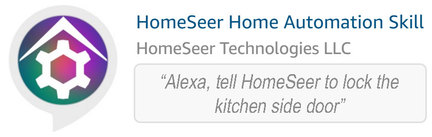

Option #2 - HomeSeer Home Automation Skill
Works with all HomeSeer Devices & Events
![1731031[1]](https://homeseer.com/wp-content/uploads/2017/07/17310311.jpg)
This skill provides complete control of your HomeSeer system and will work with all home automation devices and events. Setup is similar to skill #1 but the syntax is a bit more involved.
Sample Syntax
- “Alexa, tell HomeSeer to turn off the kitchen light”
- “Alexa, tell HomeSeer to set the thermostat to 65 degrees”
- “Alexa, tell HomeSeer to unlock the front door”
- “Alexa, tell HomeSeer to get the status of my temperature sensor”
- “Alexa, tell HomeSeer to run the SUNSET event”
Setup
- Log into your Amazon echo account, search for the “HomeSeer Home Automation Skill” and enable it.
- Enter your MyHS account credentials in the pop-up screen and click the LOGIN button. Your Amazon Echo should now be linked to your HomeSeer system.
Important: This step relies on a pop-up window. If you do not see a pop-up, be sure your browser is set to temporarily allow pop-ups and disable any pop-up blockers you may have installed. - Now, you’ll need to enable voice commands for every HomeSeer device you wish to control with your Echo. To do this, access the device management page and click on the device name you wish to enable. Then, on the Configuration tab, tick the box for voice command. If you wish to receive a voice confirmation, tick that option as well.
